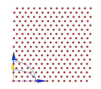

The Hexagon pattern staggers the seed points into a hexagonal distribution:
