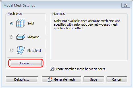

  1. Click Mesh 3D Mesh Settings.

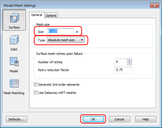

  2. Click Options...
  3. Set the Type to Absolute mesh size. Enter a size of 0.125, and click OK.

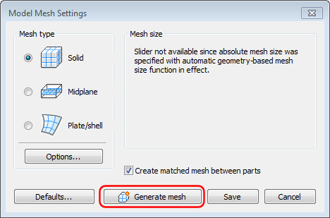

  4. Click Generate Mesh.
  5. When asked if you want to view the meshing results, click No.

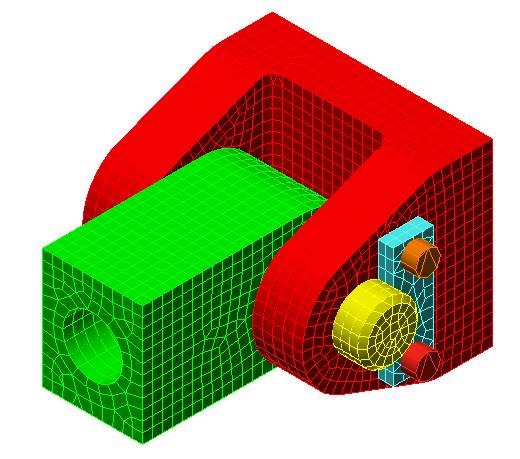

    What it should look like...
