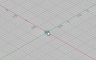

  2. Click CREATE Box. The origin temporarily becomes visible so that you can select a drawing plane for the box.
    1. Select the XY plane (by clicking the plane representation bounded by the red and green axes).
    2. Click the symbol at the coordinate origin to begin the solid box. The cursor crosshairs will snap to the origin when near to it.
    3. Move the mouse to the right to start a rectangle in the +X, +Y quadrant.
      Tip: From the mini-axis that is displayed beneath the ViewCube, you can see that the X direction (as currently viewed) is down and towards the right. The Y direction is up and towards the right.

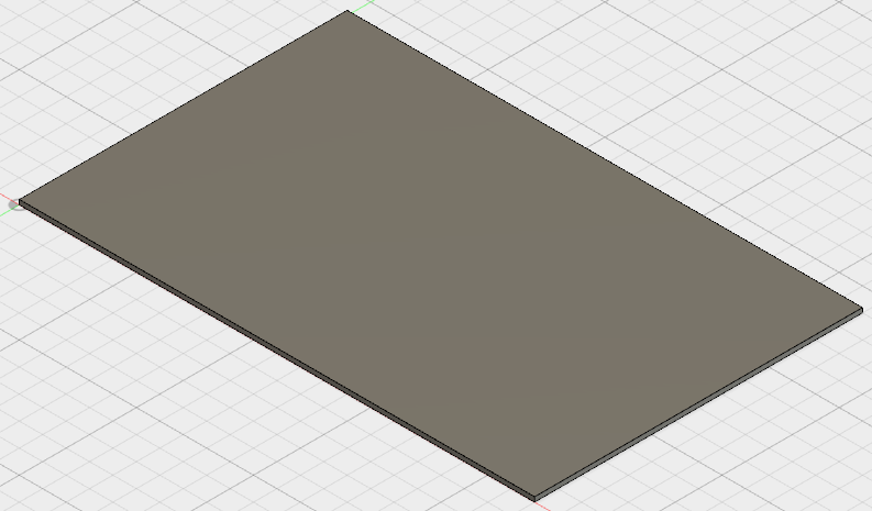

    5. Press Enter one more time to accept the base rectangle and begin the Z extrusion process. A BOX dialog box appears.
    6. Type 0.1 in the Height field.
    7. Press Enter (or click OK) to complete the creation of the solid box.
  3. In the Navigation Bar along the bottom edge of the screen, click Fit to enclose the model within the display canvas. You might need to zoom or pan further, if the model extends beyond the bottom of the command ribbon.
    The board should look like the following image:
