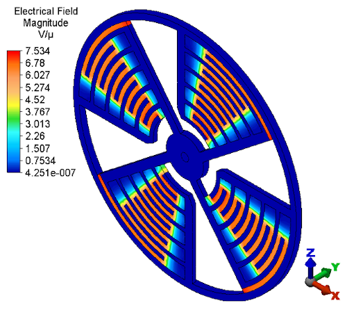

We will now review the electric field magnitude results.
  1. Click Results Contours Voltage and Field Strength Electric Field Magnitude. The electrical field magnitude results should look like the following image:

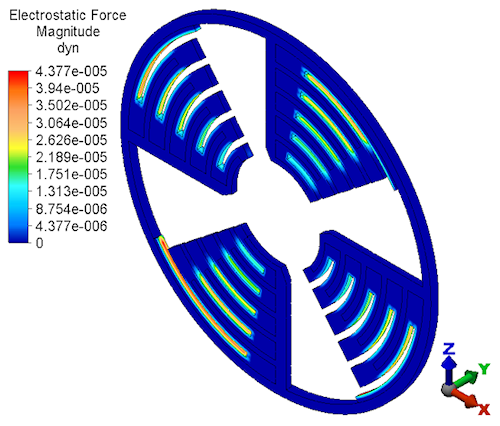

  2. Right-click the 2 < Rotor > heading under Parts in the browser (tree view) and deactivate the Visibility option to hide the rotor.
  3. Click Results Contours Voltage and Field Strength Electrostatic Force Magnitude. The electrostatic force results appear as shown in the following image:
  4. Right-click the 2 < Rotor > heading under Parts in the browser and click Visibility to unhide the rotor.
