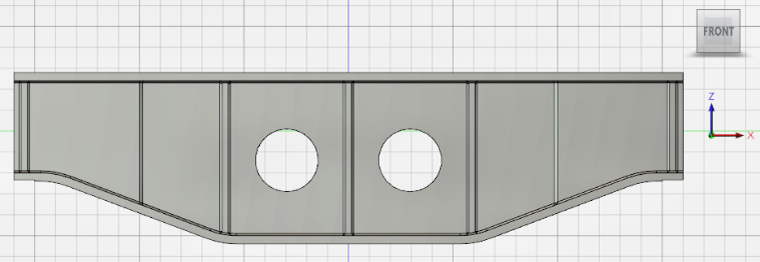

  3. Click near the middle of the FRONT face of the ViewCube.
  4. Click on the triangle below the ViewCube. The model viewpoint should correspond to the Front view in Simulation Mechanical.
    Optionally, redefine the view name to suit the model. Right-click on the ViewCube and click Set current view as Front. The ViewCube FRONT view orientation should now match the orientation in Simulation Mechanical, and the model should look like the following image:

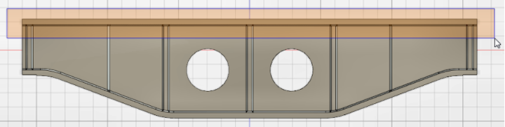

    1. In the Object section of the Move dialog box, click Move Faces.
    2. Click and drag to draw a selection window that encloses only the top flange and all of the corner chamfers on the underside of it, as shown below:
      The top flange and chamfers become highlighted in blue and a pivot point and movement triad appear somewhere along the selected faces.
      Note: The movement triad may or may not be oriented as needed, specifically with a vertical (preferably upward) movement vector. For example, the triad in the following image does not have a movement vector that is parallel with the global Z-axis of the CAD model, which is what we need.
      If a movement vector does not point in the +Z or -Z direction, perform the optional procedure under Step 2c below. Otherwise, skip to Step 2d.
    3. Optionally, to reorient the movement triad, click the Set Pivot icon in the Move dialog box. Then...
      1. Move the cursor along the horizontal or vertical edges of the model. The pivot point and triad will follow the mouse movement and reorient as you move along the various model features.
      2. Click the mouse to anchor the pivot point and triad in a new, suitable location.
        Alternatively, you can return to the Home dialog box, while avoiding dragging the cursor across the model geometry, which would again move the triad. Then, click the Done icon () to the right of Set Pivot to anchor the pivot point.
      3. Here is an example of a move-triad that is suitably oriented:
    4. Click the movement vector that aligns with the Z-axis and drag it upward a short distance. A Distance input field appears near the movement triad. Perform one of the following two actions, depending upon whether the vector points upward or downward:
      • Vector Points in +Z (Upward) Direction: Type 30 mm in the distance input field and press Enter.
      • Vector Points in -Z (Downward) Direction: Type –30 mm in the distance input field and press Enter.

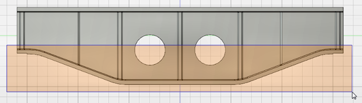

    2. Click and drag to draw a selection window that encloses only the bottom flange and all of the corner chamfers on the underside of it, as shown below. Be careful to NOT fully enclose the web holes.
      Note: Again, the movement triad may or may not be oriented as needed, specifically with a vertical (preferably downward) movement vector.
      If a movement vector does not point in the -Z or +Z direction, perform the optional procedure under Step 3c below. Otherwise, skip to Step 3d.
    4. Click the movement vector that aligns with the Z-axis and drag it downward a short distance. A Distance input field appears near the movement triad. Perform one of the following two actions, depending upon whether the vector points downward or upward:
      • Vector Points in -Z (Downward) Direction: Type 30 mm in the distance input field and press Enter.
      • Vector Points in +Z (Upward) Direction: Type –30 mm in the distance input field and press Enter.
