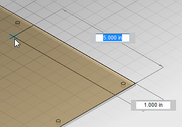

    1. Click on the top surface of the board to choose the drawing plane for the base rectangle.
    2. Click the rightmost corner of the board (as displayed in the Home View).
    3. Drag the mouse towards the opposite corner of the board to start a rectangle. One of the two dimensions is highlighted and the model appears as shown below.
      The rectangle needs to be 5.75 inches long x 0.4 inches wide. Enter the dimensions in the appropriate order, depending upon which field is highlighted first.
      1. Type 0.4 for the width (Y dimension), which is parallel to the short edge of the board, and press Enter to lock in this dimension.
      2. Type 5.75 for the length (X dimension), which is parallel to the long edge of the board, and press Enter to lock in this dimension.
    4. Press Enter to accept the base rectangle.

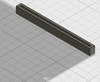

  3. Click MODIFY Shell.
    1. Click the top face of the edge connector. Be sure that you are selecting only the top face, not the entire solid part. The selection pre-highlighting indicates the extent of the selection. A shell thickness field appears with the thickness dimension highlighted.
    2. Type 0.15 and press Enter to complete the Shell command. The model should look like the following image:

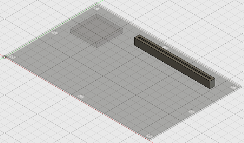

    3. Press Enter (or click OK) to complete the Move command. The model should look like the following image:
