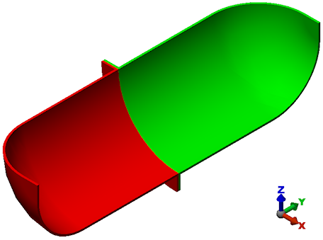

    3. Select  the file, Bolted Flange.STEP, and click Open.
  4. Ensure that the analysis type is set to Linear Static Stress with Linear Material Models and click OK.
  5. Click Yes when prompted about using the default Simulation Mechanical color pallette instead of the CAD model colors.
  6. Click Yes when prompted about importing CAD part names. The model opens in the FEA Editor environment.
