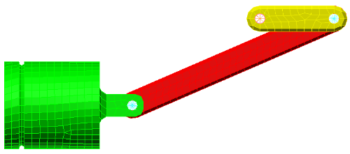

Surfaces commands still active, draw a circle enclosing the hole at the free end of the crank as shown in the following image. The centerline of this hole is the centerline of crank rotation.
Navigate
Enclose (Fit All) (or the equivalent Navigation Bar command). The model displays as shown in the following image:
