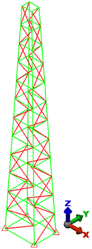

    3. Click OK.  The model opens in the FEA Editor environment, as shown below.
