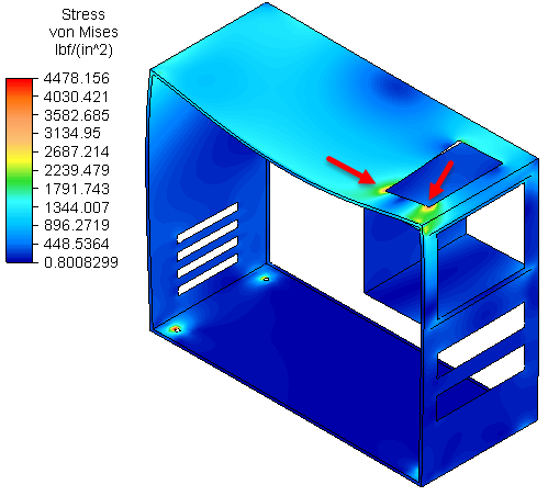

  1. Click Results Contours Stress von Mises. The stress results appear as shown in the following image.

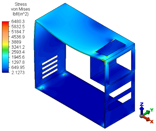

    1. Activate the Bending Stress/Strain option. Notice the change in the appearance (particularly near the cutout in the top of the case) and the new legend range:

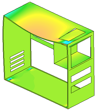

  3. Click Results Contours Stress Tensor XX Component. This contour plot clearly demonstrates the reversal in the sign of the stress tensor between the top and bottom faces of the plate elements (due to bending). The model should resemble the left image in the table below.

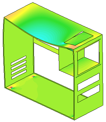

    1. Activate the Reverse Sides in Plot sub-option under the Both Sides option. The display should now resemble the right image in the table:
      Default Plate/Shell options (Sides NOT Reversed) Reverse Sides in Plot option Activated
      A positive tensor result indicates tensile stress, and a negative tensor result indicates compressive stress. The plotted colors and legend values match the actual stress or strain only when the sides are not reversed.
