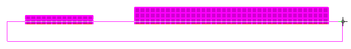

  5. Press Ctrl-A to select all of the surfaces of the visible parts.
    • While holding down the Ctrl key, click and drag to draw a selection rectangle enclosing only the bottom edge of the chip and slots, as shown below. This removes the bottom surfaces from the selection set. These surfaces are in contact with the board and are not exposed to the ambient air and associated convection load.
      Caution: Position the top of the selection rectangle only slightly above the bottom edges of the visible parts to prevent deselection of the surfaces at the bottom of the edge connector slots too.
