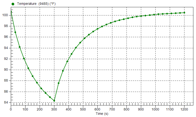

    1. Replace the number in the Nodes Graphed field with the number you recorded in Step 3.
    2. Click Apply.
    3. Click the red X in the upper right corner of the Edit Curve dialog to close it. The graph now shows the temperature result at the hottest node, and it should resemble the following image:
      The temperature of the selected node decreases about 16°F during the first 300 seconds (the cool off period). The temperature is still about 4° warmer than the ambient temperature at 300 seconds. Heat generation resumes at the rate of 5 Watts at 301 seconds and continues at that level for the remainder of the simulation event. During this 15 minute period, the chip almost reaches the steady-state temperature again (within 0.5°F).
      Notice the nonlinear cooling and heating rates:
      • The cooling rate (slope of the temperature versus time curve) decreases as the ambient temperature is approached. The rate of convective heat loss is proportional to the difference between the surface and ambient temperatures. So, when the surface temperature is close to the ambient temperature, the convective heat loss approaches zero.
      • The heating rate slows as the convective heat loss magnitude approaches equilibrium with the heat generation magnitude. When the processor is re-energized, the temperature initially increases quickly because heat input (generation) is relatively high while convective heat loss is relatively low.
