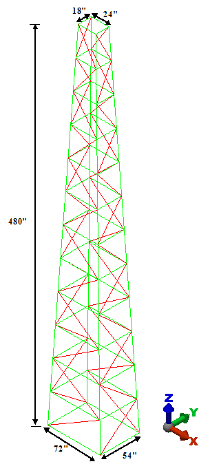

- Construct the truss tower as shown in the following image.
- The horizontal and vertical members have a cross-sectional area of 2.79 in
2
. These are shown in green in the image.
- The diagonal cross members have a cross-sectional area of 1.67 in
2
. These are shown in red in the image.
