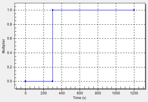

    1. Ensure that 1 is entered in the Load Curve field and click the Curve button. The Multiplier Table Editor appears.
      1. Click the Add Row button.
      2. Type 300 in the second row of the Time column. Keep the default Multiplier value of zero (0).
      3. Click the Add Row button.
      4. Ensure that 301 in specified in the third row of the Time column, and type 1 in the third row of the Multiplier column.
      5. Click the Add Row button.
      6. Type 1200 in the fourth row of the Time column and 1 in the fourth row of the Multiplier column.
      7. Press Enter. The load curve appears as shown in the following image.
      8. Click OK to accept the load curve data.
