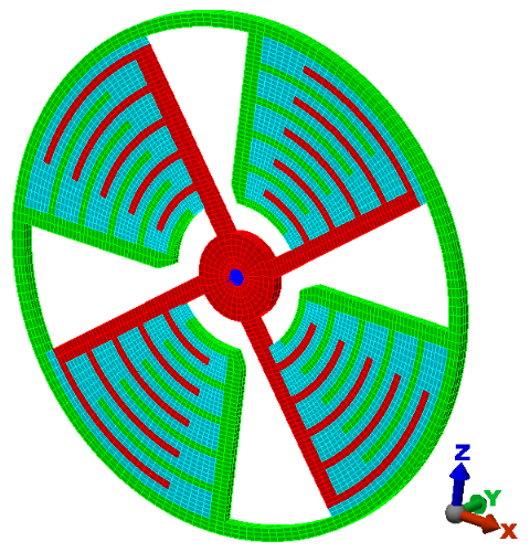

    3. Click OK. The model opens in the FEA Editor environment, as shown below.
    The analysis type has already been set to Electrostatic Field Strength and Voltage as archived.
