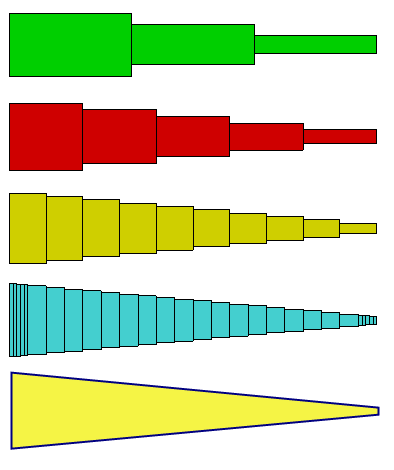

A series of linearly varying beam cross-sections can be created using the Variable Cross-Section Wizard. Each beam element has a different cross-section dimension based on interpolating the two user-specified end dimensions. The wizard creates a stepped beam that approximates a tapered beam. Any user-defined shape (rectangle, wide-flange beam, channel, pipe, and so on) whose dimensions can be entered in the normal cross-section library dialog box can be used for the variable cross-section.
 Figure 1: Variable Cross-Section Beam - four different mesh densities are shown to simulate a tapered beam with a variable height (bottom figure).

- Once the wizard completes, the part is identical to what is created by hand if you chose to enter the input for each element. I any manual changes are made to the part , such as making the member longer or shorter, rerun the wizard to compute the new values.
- Since the cross-section is calculated at the midpoint of each element, the stress at each end of the element is either an overestimate or underestimate of the theoretical result. Use more elements in the part to minimize the approximation.
