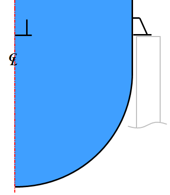

Given:
A 0.25-inch thick steel tank is supported on four base plates. The tank contains water at 150 °F and is partially filled. The tank is in a 70 °F stagnant environment.
Ambient air at 70°F ho = 1.5E-6 BTU/(s*°F*in2) |
Heated air at 150°F hi = 4.7E-7 BTU/(s*°F*in2) |
Heated water at 150°F hi = 1.3E-4 BTU/(s*°F*in2) |
Ambient air at 70°F ho = 1.6E-6 BTU/(s*°F*in2) |
Find: The thermal stress and displacement due to the contents.
This particular analysis uses a two-step analysis procedure. First, the temperature distribution of the model is calculated using a steady state heat transfer analysis. Second, the temperature is imported into a stress analysis to calculate the thermal expansion.
This example concentrates on performing the analysis, not on the creation of the model. Therefore, the model geometry is provided. Model setup consists of applying the loads as convection, and performing the analysis.

The conduction out of the 4x8 inch support pad can be estimated by using equations for a fin. Think of the tank as sitting on a 4x8 inch concrete pier {k = 1.3E-5 BTU/(s*°F*in)}. The tank end of the pier is maintained at a hot temperature, and cooling around the pier {h = 1.6E-6 BTU/(s*°F*in 2 )} creates an arrangement identical to a fin. As an approximation, assume the pier is long enough so that the floor end is at the ambient temperature {Tamb = 70°F}. The equation for the heat loss from such as fin is
| Q = (T-Tamb) [h * perimeter * k * A]0.5 | (7) |
If the pad is around 135°F, this equation yields
Q = (135-70°F) [1.6E-6 BTU/(s*°F*in2) * 24 in * 1.3E-5 BTU/(s*°F*in) * 32 in2]0.5 = 8.2E-3 BTU/s
or on a per area basis, Q = (8.2E-3 BTU/s)/(32 in2) = 2.6E-4 BTU/(s*in2).
