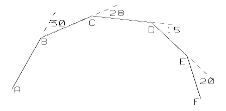

The image below gives a visual explanation of a curve angle. Whenever the angle between the starting segment and the current segment is larger than the curve angle, a new starting segment is created and the starting point of that segment becomes a node in the meshed model. If the points on a feature curve are named A, B, C, D, E, F and the angles between segments are:
AB to BC = 30
BC to CD = 28
CD to DE = 15
DE to EF = 20
Figure 1
Whenever the angle between the starting segment and the current segment is larger than the curve angle, a new starting segment is created and the starting point of that segment becomes a node in the meshed model. If the curve angle is 31 degrees, then the segments CD and EF will be new start segments and points A, C, E and F will remain nodes in the final model.
If the curve angle is 29 degrees, then segments BC and DE will be new start segments and points A, B, D, and F will remain nodes in the final model. If the curve angle is 31 degrees, then segments CD and EF will be new start segments and points A, C, E, and F will remain nodes in the final model. If the curve angle is 60 degrees, then segment DE will be new start segment and points A, D, and F will become nodes in the final model.
