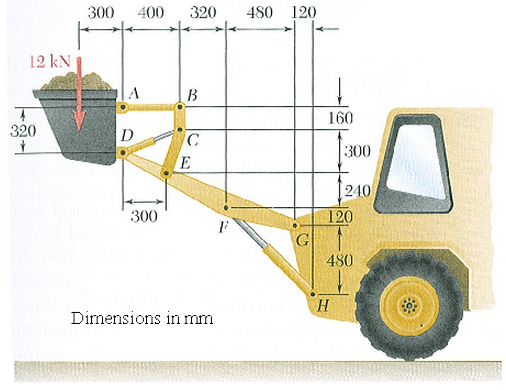

Given: The bucket of the front-end loader consists of two identical mechanisms. Each mechanism carries a load of 12 kN (24 kN total for the front-end loader) as shown in the figure below. Include the live load and gravity in the analysis.
Find: A preliminary design with:
- the optimum cross sections for the three links AB, BCE, and DEFG, based on minimizing the weight of the structure and limiting the stress to 100 MPa
- the size required for cylinders CD and FH.
Figure 1
Since we are after a preliminary design and only considering in-plane effects, the shape of the cross-section is not overly important. Thus, beam elements with a rectangular cross section will be used. (Once the solution is found, a different shape with similar area and section modulus can be substituted, if needed.)

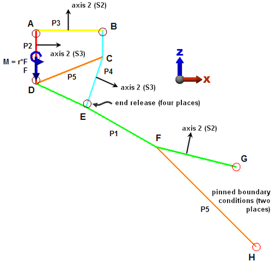

The model is planned as in Figure 2. The orientation of the model can be in any direction since beam elements are three dimensional, but let's use the XZ orientation of the model shown in Figure 2. (This makes the Front view natural.) The different part numbers are shown (P) based on the above table.
For beam elements, the orientation of axis 2 needs to be decided to enter the cross sectional properties. The desired orientation scheme is as follows:
- Axis 2 (weak axis of bending) lies in the plane of the model
- Axis 3 (strong axis of bending) points out of the model plane (parallel to the global Y-axis).
The orientation of beam elements is controlled by the surface number of the lines. The surface numbers shown in Table 1 and in Figure 2 produce the desired beam element orientation. (See the paragraph Beam Element Orientation on the Beam Elements page for more information.)
Figure 2: The FEA Model
Part numbers (P), axis 2 orientation decided by the user, and surface numbers (S) dictated by the orientation, are added to the figure.

- Start drawing the mechanism at point G. Add a line using Draw
Draw
Line. - Remove the check from the Use as Construction check box.
- Set the Part number and Surface number to 1 and 2, respectively, per Figure 2.
- Start the line at (0,0,0), and then activate the Use Relative check box. Per Figure 1, put the next points at the following relative positions. (To enter a coordinate, put the cursor in the X, Y, or Z box (or DX, DY, DZ), type the value, and press the Enter key.)
| Point |
Relative Distance From Previous Point |
| F |
(-480,0,120) |
| E |
(-420,0,240) |
| D |
(-300,0,140) |
Table 2

- On the add line dialog, set the Part number and Surface number to 2 and 3, respectively, per Figure 2.
- Enter the next point A at a relative coordinate of (0,0,320).
- Set the Part number and Surface number to 3 and 2, respectively, per Figure 2.
- Enter the next point B at a relative coordinate of (400,0,0).
- Set the Part number and Surface number to 4 and 3, respectively, per Figure 2.
- Enter the next point C at a relative coordinate of (0,0,-160).
- The final segment of link BCE can be snapped to point E using the mouse. (The cursor will change to a padlock when the mouse is near point E, and clicking will snap the line segment to the point.)

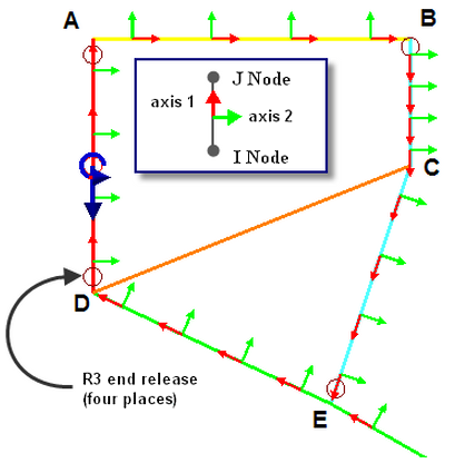

- By default, the connection between beam elements is a rigid connection. Therefore, end releases need to be added at points A, B, D, and E to simulate the pinned condition. Based on the chosen orientation, we know that the moment about axis 3 (R3) needs to be released, but we do not know a priori whether to release the moment on the I end or the J end of the element. This can be determined by displaying the beam orientation marks (View
Visibility
Object Visibility
Element Axis 1 and Element Axis 2). This shows us that R3 needs to be released on the I end of the beams at points D and B, and the J end of the beams at points A and E. (See Figure 3.) So, - Select the beam element in the bucket at point D and in link BCE at point B (Selection
Select
Lines, click the first line, hold the Shift key and click the second line),
- Right-click and choose Add
Beam End Releases.
- Activate the R3 check box for the I Node.
- Click the OK button to apply the end release.
- Repeat the process for the elements at points A and E and activate the R3 check box for the J Node.
- When done properly, the end release symbol will appear on the proper end of each beam element as shown in Figure 3.
Figure 3: View Beam Orientations to set the Proper End Releases
The orientation marks at the center of each element show which direction is axis 1, and this determines which node is I and which is J. (Axis 1 runs from node I to node J.)
