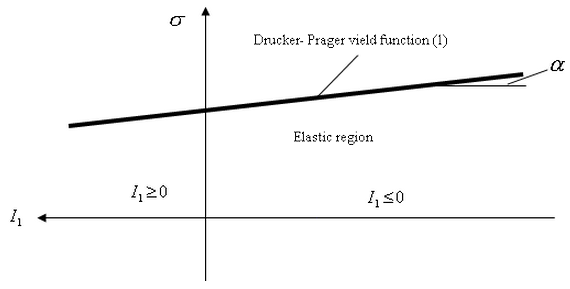

Figure 1: Graph of the Drucker-Prager Yield Function
The Drucker-Prager yield criterion will be identical to the von Mises perfect plastic yield criterion if the following criteria are met:
(5)

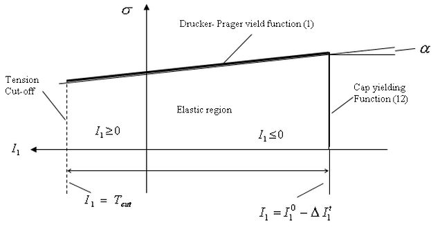

Modified Drucker-Prager Yield Criterion/Yield Function
The Drucker-Prager yield criterion does not take into account two properties of geological materials. First, most geological materials provide little or no resistance to tensile loads. Second, the yield surfaces and strengths of geological materials often depend on the pressure loads. The Modified Drucker-Prager material model will account for these properties. This model includes three sections as shown in Figure 2. The area where I1 is larger than the tension cut-off, Tcut, is defined as the tension cut-off region. The region where I1 is less than the cap yielding function defined as the cap hardening area.
Figure 2: Graph of the Modified Drucker-Prager Yield Function
Tension Cut-off Region
Once the tensile stress exceeds the value Tcut, there are three options that can be used to handle the stresses while maintaining the stability of the iterative solution process.
1. A residual stiffness, Kres, will be used. This will be calculated as:
(8)
where rres is the residual stiffness factor and Ke is the original elastic stiffness. The factor rres must be between 0.0 and 1.0.
2. The three normal stresses will be set to one-third of Tcut and the three shear stresses will be set to 0.
3. All normal and shear stresses will be set to 0.

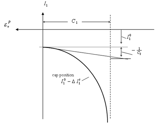

The physical meaning of the various cap function coefficients is shown in Fig. 3. From this figure, it may be seen that the coefficient C1 represents the maximum plastic volumetric strain the material could ever reach, and C2 gives a measurement of the cap position increasing rate.
Figure 3: Graph of the Cap Hardening Curve
