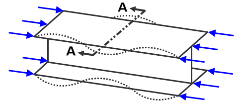

The element types available for critical buckling are beams, plates, and bricks (and their variations). The element chosen can affect the type of buckling multiplier calculated. For example, beam elements are only a line with the cross-section represented mathematically; beams can only calculate a global buckling. Plate and brick elements can calculate localize buckling since the cross-section is modeled with elements. See Figure 1.
(a) Beam elements give a global buckling shape and load multiplier.
(b) Plate and brick elements can give global and local effects. In this example, the flange of the beam buckles locally which may be at a critical load less than the load to cause global buckling.

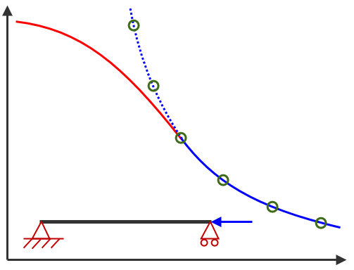

Since the critical buckling is calculated by solving an eigenvalue problem (like a modal analysis), the results are suitable for thin and slender structures (like Euler columns). No corrections are incorporated for short columns, thick plates (compared to the length and width of the plate), or the yield strength of the material. See Figure 2. Also, it is a linear analysis. There are no stiffness changes due to the deflection and therefore no large deflection effects such as P-delta (load-deflection) effects. Consequently, the critical load and buckling mode shape can be determined, but what happens after buckling is not available. (Perform nonlinear analysis if post-buckling results are needed.)
Critical Load
Slenderness Ratio
Figure 2: Eccentric Load on Column or Bar
Euler Equation,
Johnson correction,
calculated results)

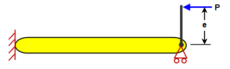

Loads that do not cause compression do not affect the buckling calculation. It is important to note that when calculating the critical buckling load for beam elements, only the axial component of the loads are considered. For example, imagine an offset load on the end of a bar (see Figure 3(a)). It can be represented as an axial load and moment on the end of a beam model (Figure 3(b)). Since the moment does not create axial stress in the beam elements, the offset load in this analysis produces the same result as a pure axial load. (The moment creates bending stresses; the theoretical compression on one side of the beam element does not affect the buckling calculation.)
(a) Physical model of a bar with a load P offset from the centerline by a distance e.
(b) Beam model created in FEA. The load eccentricity results in a moment applied to the node. Due to the nature of beam elements and critical buckling, the moment does not affect the results. The wrong element type is used in this example.
Figure 3: Eccentric Load on Column or Bar
