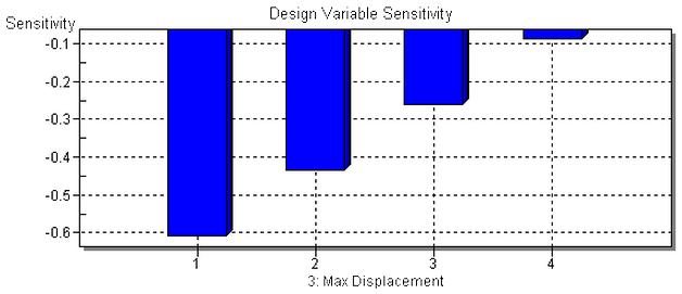

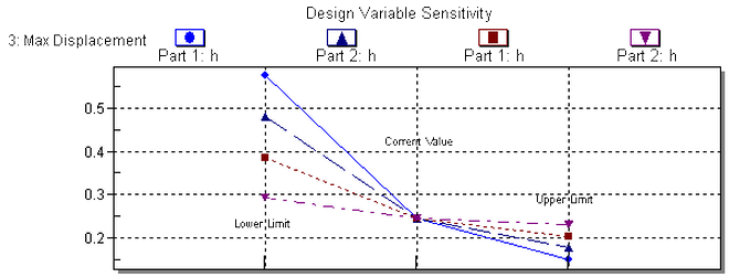

The results of a Design Study can be viewed with the Results: Design Variable Sensitivity menu. Three kinds of graphs are available:
For example, if the objective is maximum displacement, then the graph will show how the displacement is affected by changing each design variable. If the sensitivity is negative, the objective will decrease by the amount shown by increasing the design variable. In Figure 1, the affect on the maximum displacement by increasing each of four design variables by one unit is shown. Changing design variable 1 has the largest effect on reducing the displacement.
Figure 1: Design Sensitivity Graph
Figure 2: Design of Experiment Graph

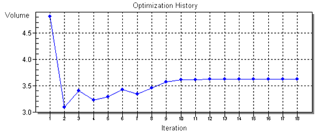

The results of a Design Optimization can be viewed with the Results: Design Optimization History menu. A line graph is shown for the select objective of design variable at each iteration. Be sure to check the objective being minimized (or maximized); it should appear to be converged if sufficient iterations were specified.
Figure 3: Optimization History for Volume
