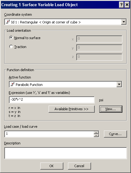

If the variable pressure is applied in a constant direction, select the Traction radio button in the Load orientation section and define the direction as a vector in the X, Y, and Z fields.
When creating a new load, the Active function drop-down menu is set to New function. Either type a name to create a new function, or use the drop-down menu to select an existing function. If you change the parameters of the function, the changes are applied to every variable pressure in the model that uses that function.
Define the function in the Expression field. The equation represents a pressure applied to the surface. Use the variables r, s, and t in the expression; note how the definition of these variables changes depending on the coordinate system as shown on the dialog box. You can use basic operators such as + - * / ( ) and ^. Click the Available Primitives >> button to access several common functions.

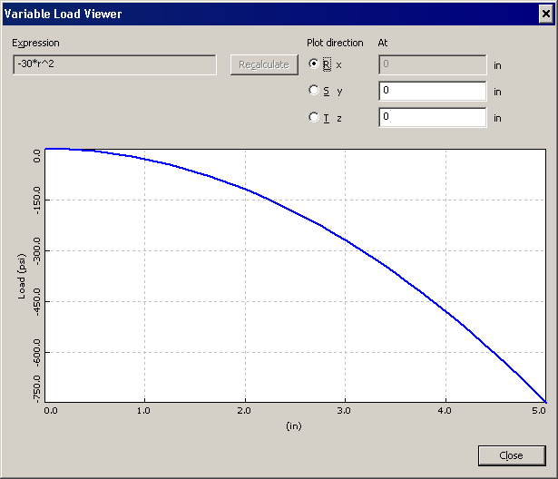

Click the View button to see a graphical view of the load along a specific direction. You can select the radio button for the variable plotted along the abscissa axis (the X axis) of the graph. Define the other two coordinates if they are used in the expression. For example, if you have a load that increases linearly in the X direction, select the X radio button. It generates a straight line at a constant slope. Since the load does not vary in the Y or Z directions, it does not matter what values are entered for these coordinates. If the expression were 5*(X+Y) and you chose the X radio button to see how the pressure changes versus the X coordinate, then you need to enter a specific value for Y. The graph will show how the pressure varies in the X direction based on the entered Y coordinate. You can view the graph at different Y coordinates by changing the coordinate and pressing the Recalculate button.

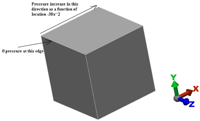

We will set up and view a model of a 5 inch cube with the following variable loading.
First we should set up a rectangular local coordinate that has the origin along the edge of 0 pressure and the local X axis parallel to the direction of increasing load. Next we select the surface and right-click in the display area and select the

Surface Variable Pressure command. The variable pressure parameters should be set as shown below.
Click the View button to show the following graph along the X direction.

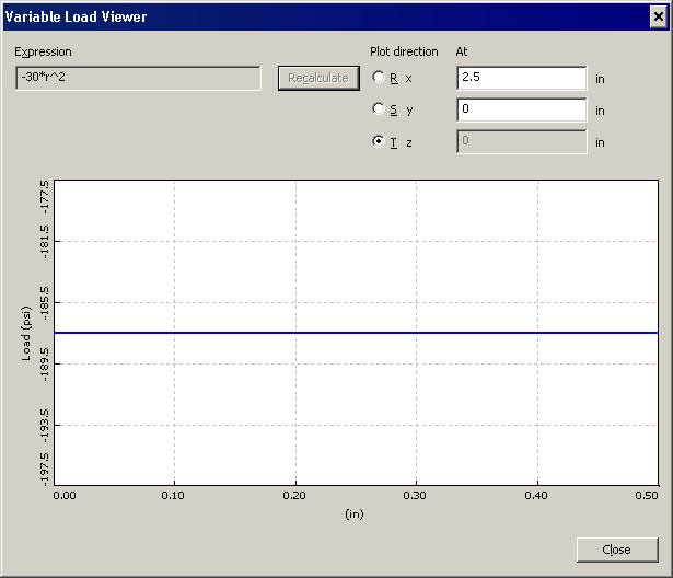

Since the model does not vary in the Y or Z directions, the values in the y and z coordinate fields are not relevant. For verification purposes, the value half way along the surface should be constant at -30*(2.5)^2 = -187.5. Select the T radio button and type 2.5 in the R field. Press the Recalculate button. The following graph should appear.
