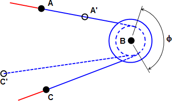

The pulley (shown in blue) is defined by the Driver (point A), Pivot (point B), Slack (point C), and the Pulley Radius (see below). The other elements connected to the pulley – such as truss elements – are shown in red. As point A moves to A', point C moves a corresponding distance to point C'. The wrap angle (φ, as shown in the figure) is determined by the software and may change during the analysis.
