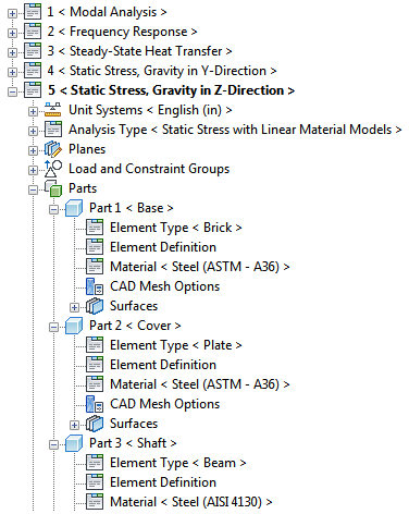

One FEA model (one .FEM file) can contain numerous analyses or Design Scenarios. The results of each scenario are saved in a separate folder under the main model folder. For example, one model could contain all these analyses:
The tree view for the above design scenarios is shown in the following image (scenario 5 is active).
