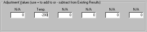

- Specify -200 (negative 200) for the Temperature Adjustment Value. This will reduce all calculated temperatures by 200 degrees. (For a heat transfer analysis, only the second degree of freedom, the temperature, is used.)

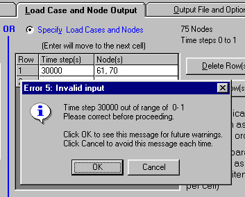

- On the Load Case and Node Output tab, choose Specify Load Cases and Nodes. In Row 1, enter a Time Step of 30000. You will get a warning message that this time step is beyond the range of the current results 0-1. Click OK. When the New Results file is created, this invalid time step will automatically be adjusted to the last time step in the analysis, as shown in the error log file.

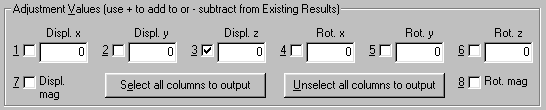

- Since only the Z displacement is required, turn off all the check marks except for the Displ. z in the Adjustment Values section.

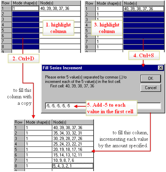

 Reverse the Results: Imagine that for whatever reason, you want to have the results for a 40 node model output in reverse order, from the last node to the first node. The Load case spreadsheet is the obvious way to accomplish this. Unfortunately, the nodes cannot be specified as 40-1; the Nodal Results Translator automatically reverses the node order to be in ascending order (nodes 1-40) when the Create File button is clicked. Instead, enter the first row of data, and then use the hot keys to fill in the load case spreadsheet using the 5 steps shown in the figure. To make the grid easier to read (and easier to type), enter the first 5 node numbers on the first row, in reverse order of course.

- Uncheck all the Adjustment Value boxes except for the Force z box.

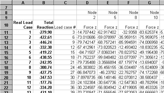

- Create the new results file and open it with your spreadsheet program.
- The case number and support reaction at the individual nodes are not of interest in this case. So insert two columns into the spreadsheet. In the first column, add a formula for the real load case which equals the file's load case divided by 3 (formula in cell A11 = C11/3, copied down the 20 rows). In the second column, add a formula that sums the values for all the nodes on the row (formula in cell B11 = sum(D11:J11) if there are 7 nodes with supports).
