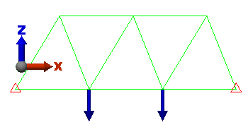

This warning often occurs when working with 2D truss models. Since the truss element is a 3D element, and because each joint is pinned, the truss elements cannot prevent the unrestrained nodes from moving in the out-of-plane direction. See Figure 1. Other element types can produce similar warnings.
Figure 1: Example 2D Truss Model
Since the structure is planar and the joints are pinned, the truss elements provide no resistance or axial force in the Y direction. Therefore, a warning is given for all nodes except for the two with a Ty boundary condition.
