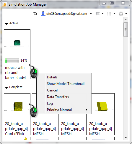

The context menu contains several tools for gaining additional insight into the progress of your simulation.
The context menu options change based on the current context:
- Details: Opens a detail view of the selected job and lists the status; job type; priority; scheduled, started, and completed time; source computer; and the thumbnail image of the model. While running, a progress bar indicates the progress of the simulation. Click
OK to close the detail view.
- Open: Opens the model in the simulation software.
- Show Model Thumbnail: Opens the model thumbnail image in your default application images. The Windows file association settings for this file type determine which application opens the thumbnail image.
- Show Convergence Plot Thumbnail: Displays the image file of the simulation convergence plot.
- Cancel (while running): Stops the running job. No additional results are saved to the local workstation for visualization. Note that cloud credits are refunded when you cancel a job.
- Delete (when complete): Click to remove a job from the
Complete list. Note that the job is not deleted from your local computer.
- Data Transfers: Opens a summary of the data uploaded and downloaded to and from the cloud.
- Log: If an error occurs, the log file can be a useful source of information. This log file contains a lot of highly technical information. A Technical Support Engineer may request it from you in the event of a problem.
- Priority (while running): Set the priority of jobs run with the
Local Solve option. By default, Local jobs are
Normal priority. This means that they run in the order in which they are submitted. If, however, it is necessary to run a local job sooner than in the submitted order, increase its priority to
High. This causes the job to run next, after the current job is finished, regardless of how many jobs were submitted before it. Likewise, to cause a job to run later than in the submitted order, change its priority to
Low. (This option is available only for
Local
jobs.)
