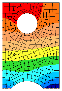

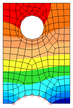

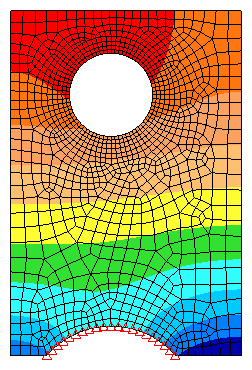

Some types of one-way coupling permit the meshes to be different in the two models. This allows the mesh to be optimized in both models. (Of course, the meshes can be identical also.) See Figure 1 for an example. Refer to the respective page for each loading type to see whether different meshes are supported or not.
(a) Temperature results from a thermal analysis |
(b) Loaded into a stress analysis with a coarser mesh. |
(c) Loaded into a stress analysis with a finer mesh. |

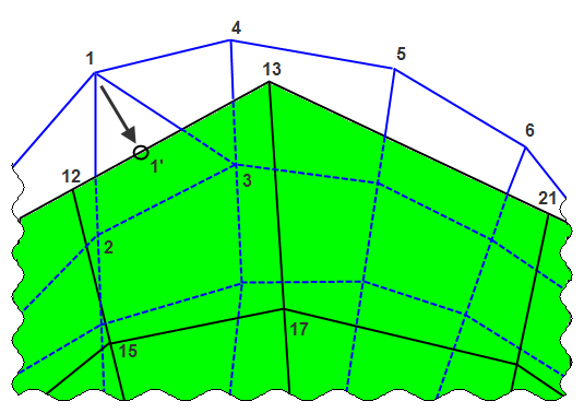

When the type of load supports different meshes in the two models, the model with the results must be a complete model. The results will be transferred between different meshes by mapping the nodes in each part of the result's model to the same part number in the target model. The mapping is as follows:
A highly magnified drawing (and exaggerated for clarity) of two meshes of the same part in two different models. The results are being transferred from the model shown in green and shaded to the mesh of the target model (shown in blue, un-shaded, and behind the mesh of the results model). Node 1 is outside the volume of the results mesh, so it is projected onto the surface of the results (point 1'). Shape functions are used to interpolate the result from element 12-13-17-15 to the nodes 1', 2, and 3. The result at 1' is assigned to node 1.
Figure 2: Example Node Mapping

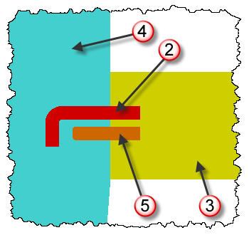

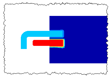

Since the mapping is performed on a part-by-part basis, different parts can be activated or deactivated in each model. For example, imagine using the voltages from an electrostatic analysis in a stress analysis to calculate the piezoelectric effect. The electrostatic model may include the air in the analysis in order to have the proper electrostatic field. But the air is not relevant to the stress analysis, so it can be deactivated. Likewise, if there were a part needed for the stress analysis which has no influence on the electrostatic analysis, it can be deactivated in the electrostatic analysis. See Figure 2.
If only the results file exists, see the section "Requirements for Same Meshes" below.

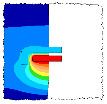

(a) complete model with parts 2 through 5. Part 3 is an insulator, and part 4 is air. |
(b) The voltage result from an electrostatic analysis. Part 3 is not included in the analysis. |
(c) The voltage load in a stress analysis. Part 3 is included; part 4 is not included. |
| Figure 3: Different Part Numbers in Electrostatic and Stress Model |
