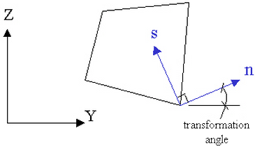

-  Orthotropic: If the material properties vary along three orthogonal axes but not with temperature, select the Orthotropic option. If the Orthotropic option is selected, you will be able to orient the material axes using the Principal Axes Transformation Angle field. The local n material axis is measured counterclockwise from the Y axis as shown in Figure 3.

-  Temperature Dependent Orthotropic: If the material properties vary along three orthogonal axes and change with temperature, select the Temperature Dependent Orthotropic option. You will be able to orient the material axes using the Principal Axes Transformation Angle field. The local n material axis is measured counterclockwise from the Y axis, as shown in Figure 3.

Figure 3: Principal Axes Transformation Angle

- If you selected the Orthotropic option in the Material Model drop-down box and the principal axes do not lie on the global XYZ axes, specify the rotation angle value in the Principal Axes Transformation Angle field. This angle is measured counterclockwise from the global Y axis to the material axis in degrees.
