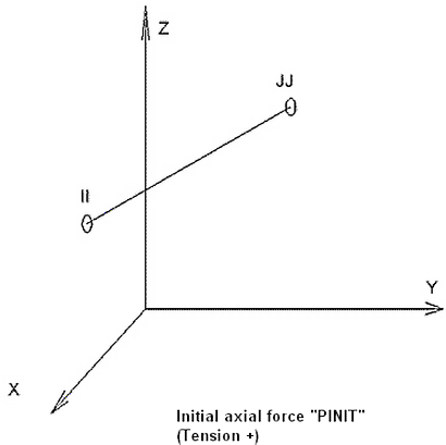

Truss elements are two-node members allowed arbitrary orientation in the XYZ system. The truss transmits axial forces only, and in general, is a three degree-of-freedom (DOF) element (three global translation components at each end of the member).
The three-dimensional (3D) truss element is assumed to have constant area and can be used in linear elastic analysis, materially nonlinear and large displacement geometrically nonlinear analysis. In the large displacement analysis, the Updated Lagrangian formulation is used, but small strains are assumed in the calculation of element stresses.
The 3D truss element can be used as a constraint element to specify the non-zero displacement, uO, on the boundary of the structure by providing the truss element with a very high stiffness, k (10 6 times the largest stiffness in the model), and applying the load k x uO to the structure in the same direction as defined by the truss element.
Figure 1: 3D Truss Element
