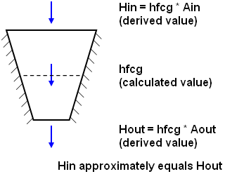

This can lead to some apparent discrepancies when the elements are skewed or the faces of the elements are not parallel and perpendicular to the heat flux vector. For example, imagine a steady state situation of heat flowing through one trapezoidal element with insulated sides (see Figure 1(a)). In reality, the heat flowing in (Hin) equals the heat out (Hout). In the FEA process, the heat flux at the centroid is calculated (hfcg), and then the heat flow through the faces is derived. As shown in Figure 1(b), this leads to an approximation which results in the two heat rates with slightly different values.
| (a) In a hypothetical model, the heat rate (H) passing through any area is equal, whether at the inlet face, the centroid (cg), or the outlet. | (b) In FEA, the heat flux (hfcg) calculated for the centroid is used to calculate the heat rates (H) through the faces. If Ain and Aout do not equal Acg, the heat in will not equal the heat out. |
Figure 1: Heat Rate Through Face Calculation H = heat rate, A = area, hf = heat flux |

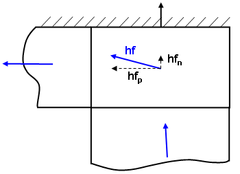

This calculation procedure can also result in situations where the heat rate through face shows a small heat value going through an adiabatic wall (see Figure 2), or similar to Figure 1, a situation in which the heat leaving the boundary of one part does not equal the heat entering another part (see Figure 3). These effects are due to the approximation of the heat rate calculation.
Hout = hf n * Area of face
Figure 2: Heat Rate through Face Projected From Heat Flux
For the heat rate passing through a face, the heat flux vector (hf) is broken into components parallel (hfp) and normal (hfn) to the face. The small normal component can appear to violate the adiabatic condition. A smaller mesh at the wall can help minimize such problems. Alternatively, add a small, insignificant convection load to the adiabatic face and set the Heat Flow Calculation drop-down on the Element Definition dialog to Linear Based on BC.

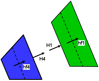

(a) A two part model: part 1 (green) on the outside and part 4 (blue) on the inside. The diameter of the centroid of the inner elements in part 1 is D1. The diameter of the centroid of the outer elements in part 4 is D4. |
(b) Detail of two elements from the model, shown magnified and separated for clarity. The heat fluxes hf4 and hf1 are calculated from the temperature distribution. The heat rate leaving the outer face of part 4 (blue) is proportional to H4 ~ hf4 * D. The heat rate entering the inner face of part 1 (green) is proportional to H1 ~ hf1 * D. Since the diameter D is slightly different than the diameters of the centroids D1 and D4 where the heat flux is calculated, the two heat rates will not be identical. |

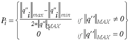

Precision is a method of highlighting stepped changes in results from one element to the next. In an ideal model, the heat flux would change smoothly between adjacent element. In the process of discretizing the model with elements, there will always be some change in results from one element to the next. The results are not continuous.
In thermal analyses, the precision is based on the discontinuous heat flux magnitude from element to element (across element boundaries). It is calculated as follows:
where:
P i is the precision at node i,
max is the maximum heat flux magnitude at node i obtained by finding the maximum over its neighboring elements,
min is the minimum heat flux magnitude at node i obtained by finding the minimum over its neighboring elements,
MAX is the global maximum of the heat flux magnitude.
Based on the formula, the range of precision values is 0 to 0.5, inclusive.
If the model is partially hidden, the precision calculations are based on the restricted set of nodes and elements. Nodes which belong to a single element will have a precision of zero.
