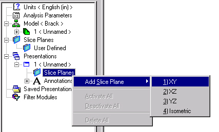

You can use the ribbon commands or a context menu to create a slice plane. For the latter method, right-click the Slice Planes heading in the Presentation section of the browser, as shown in the image below. Select the Add Slice Plane command and then select one of the options in the next pull-out menu.
Once one of the four slice plane options is selected, it will appear on the model and the commands under Slice Planes in the ribbon will become active.

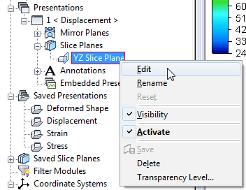

To return to Edit mode, you must right-click a previously defined slice plane heading under the current Presentation in the browser and choose Edit (as shown in the following image):
The remaining commands in the Slice Plane context menu of the browser are as follows:
