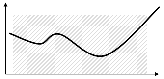

Objective/Constraints Design Range (a) The theoretical curve of the objective/constraint equation. The minimum is obvious if the curve is known, but it is not known ahead of time. Numerical methods calculate the curve and try to locate the minimum with the least computational effort. |

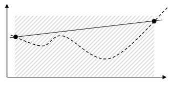

![]() (b) With the SLP method, the curve is evaluated at the upper and lower limit of the design range. Since the lower limit is the minimum, the line search begins at the lower limit. |

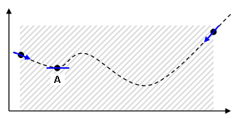

![]() (c) Using various parameters, the search routine finds a minimum at point A on the theoretical curve. Once a minimum is located, the solution has converged. It is not the absolute minimum but a local minimum. |

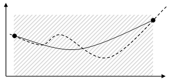

![]() (d) With the SQP method, a quadratic equation is used to estimate the theoretical curve. |

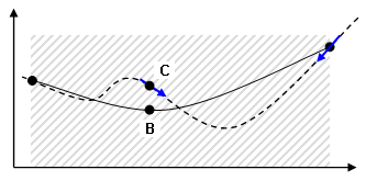

![]() (e) The minimum of the quadratic equation occurs at B. At this value of the design variables, the theoretical curve is at C and has a calculated slope. |

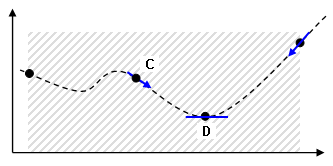

![]() (f) The search routine uses various parameters to find a minimum point D on the theoretical curve. Once a minimum is located, the solution has converged. |
