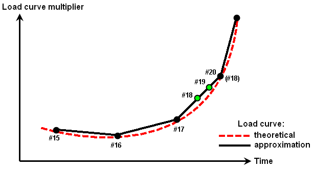

When approximating a higher order curve with a series of straight line segments, the spacing of the points in the load curve should be smaller than the smallest time step that will be encountered in the analysis. For example, imagine a runway crane that accelerates at a known rate. This is simulated by applying a prescribed displacement at the location of the wheels, where the displacement versus time is d = 0.5*a*t^2. If the load curve is calculated and entered at time steps t based on the capture rate, then the curve is followed precisely as long as the time steps are never reduced in the analysis. As soon as the time step is automatically reduced to converge on the solution, the load curve is interpolated. When this occurs, the prescribe displacement is not following the precise acceleration equation. See Figure 1.
Figure 1: Section of a Load Curve
Time steps #15, #16, and #17 follow the theoretical curve. If step #18 were able to converge, the load would still be on the theoretical curve (#18). But when the time step is reduced, steps #18 and #19 are interpolated, so this results in a slightly different load. In many cases, the difference is negligible (especially considering the approximations made by FEA in general).

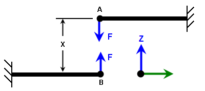

Imagine magnetic contacts in a switch assembly. The force due to magnetic attraction is not a known function of time because the displacement of the contact (due to other loads in the analysis) versus time is unknown. The magnetic force varies depending on the separation between the parts. In this situation, define a load curve as a function of a result, and the analysis will vary the load appropriately throughout time.

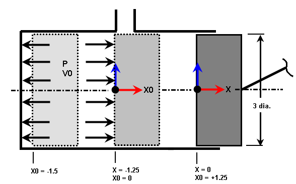

For example, imagine a 2-cycle engine, shown schematically in Figure 2. Note that the piston's position is the same in figure 2a as in figure 2b. However, the pressure in figure 2a is based on the supply pressure and the motion of the piston since the exhaust port became closed (compressing the gas), and the pressure in figure 2b is based on the combustion pressure and the motion of the piston since combustion (expanding the gas). Thus, the load curve cannot be based on the piston's position, but it can be based on the piston's position and velocity. This type of control is obtained by using the Condition text box. The format is as follows:

(a) The supply gases are compressed. |
(b) The combustion gases are expanding. |
Figure 2: Two-Cycle Piston Although the position of the piston is the same in these two positions, the pressure P is different. |

For the magnetic force example shown in Figure 3, imagine the following parameters:
Figure 3: Magnetic Attraction Example

Select
Vertices) and apply a nodal force (right-click Add
Nodal Force). Set the magnitude of the force to -1 and the direction to the Z direction. By using a unit force, the load curve multiplier will be the total magnetic force. Click the OK button to apply the force.
Select
Nodal Force). Set the magnitude of the force to +1 and the direction to the Z direction. Click the OK button to apply the force.
Nodal Probe). Enter a description of Bottom Node and click the OK button. | Index | Separation | Multiplier 1 |
| 1 | 0 | 100 |
| 2 | 0.1 | 31.25 |
| 3 | 0.2 | 7.81 |
| 4 | 0.3 | 3.47 |
| 5 | 0.4 | 1.95 |
| 6 | 0.5 | 1.25 |
| 7 | 0.6 | 0.868 |
| 8 | 0.7 | 0.638 |
| 9 | 0.8 | 0.488 |
For the 2-Cycle piston shown in Figures 2 and 4, imagine the following (fictitious) parameters:
Figure 4: 2-Cycle Piston Example
The piston is shown in three positions. X=0 is the position the model is drawn, X0=0 is when the exhaust port becomes blocked, so the trapped gases have a volume of V0 and pressure P, and X0=-1.5 is the forward position of the piston.

Select
Surfaces) on the blind end of the piston and cylinder head and apply a unit pressure of 1 psi (right-click and Add
Surface Pressure/Traction). Check the box Follows Displacement and click the OK button to apply the pressure.
Select
Vertices), right-click, and choose Add: Nodal Probe. Enter a description of Piston and click OK to add the probe. Pinitial*Vinitial = P*V
Psupply*V0 = P*(V0+X0*(pi/4)*Bore^2)
(10 psig + 14.7 psi)*(14.2 inch^3) = (Pc+14.7 psi)*(14.2 inch^3+7.0686*X0)
Pc = 350.74/(14.2+7.0686*X0) - 14.7
and for the expansion stroke, the gage pressure Pe can be calculated from
Pcombustion*(V0 - (stroke)*(pi/4)*Bore^2) = P*(V0+X0*(pi/4)*Bore^2)
(1000 psig + 14.7 psi)*(14.2 inch^3-10.60 inch^3) = (Pe+14.7 psi)*(14.2 inch^3+7.0686*X0)
Pe = 3652.92/(14.2+7.0686*X0) - 14.7
| Index | X0 |
Multiplier 1 (gases expanding, Pe) |
Multiplier 2 (gases compressing, Pc) |
| 1 | -1.75 | 1981 | 177 |
| 2 | -1.5 | 1000 | 82.8 |
| 3 | -1.25 | 666 | 50.7 |
| 4 | -1.0 | 498 | 34.5 |
| 5 | -0.5 | 328 | 18.2 |
| 6 | 0 | 243 | 10 |
| 7 | 0.1 | 10 | 10 |
| 8 | 10 | 10 | 10 |
Note the gradual change in pressure as the exhaust port is opened (0<X0<0.1). Also, the piston theoretically never displaces to positions -1.5<X0, but some lead way is necessary for round off and deflections of the system. Thus, the load curve is calculated for a stroke of -1.75.
