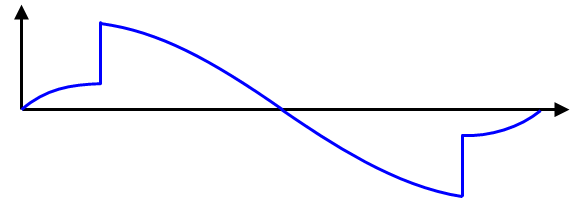

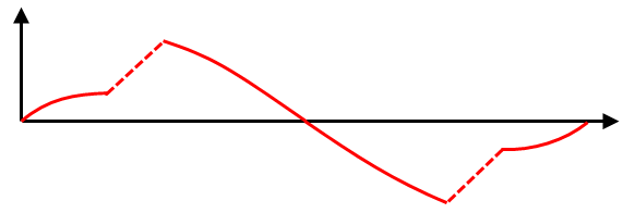

Lines), right-clicking, and choosing Invert I and J Nodes. In a normal beam member, the displacement and rotation result is continuous from one element to the next. Since end releases free a translation or rotation at a node, there is a theoretical step-change in that result at the node. For example, a rotational end release creates a hinge. The rotation angle at the end of one beam does not equal the rotation angle at the start of the next beam. (See figure (a) and (b) below.) However, the FEA results give just one value of displacement and rotation at a node. Therefore, the effect of the end release is not visible at the node. (See figure (c) below.) If necessary, add an extra node close to the end release to see the effect more clearly.
(a) Fixed-fixed beam with a hinge point at 1 and 2.
(b) The theoretical rotation or slope of the beams. Note how the result is discontinuous at the hinge points.
(c) Since there is only one rotation result in the analysis at the hinge points 1 and 2, the rotation results are presented as continuous. The length of the step (shown by dashed lines in the figure) is determined by the size of the element with the end release.
