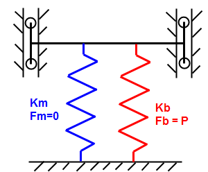

Consider a beam (represented by red spring K b ) that is stretch to create a preload of amount P, and then attached to the members (represented by blue spring K m ). The beam and member then compress an amount Δ. Since the beam is stretched before attaching to and compressing the member, the final load F' in the beam equals the preload minus the stiffness times the compression, while the equal (but opposite) load in the member equals the stiffness times the compression. Thus, there are two equations and two unknowns (F' and Δ).
Final load in beam F' = P - KbΔ
Final load in member F' = KmΔ
Solving these two equations for the final load F' gives
F' = P[Km/(K m +Kb)]
where Kb is the stiffness of the beam, Km is the stiffness of the member, and P is the preload applied to the beam.
