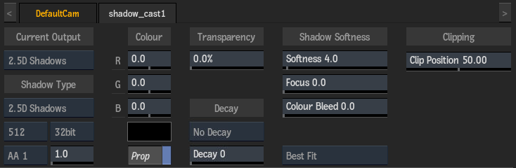

The Shadow Cast menu settings are described as follows. Shadow types are dependant on your graphics card, so you may not see all of these settings.
- Shadow Output Type box
- Select the type of shadow to output. This setting is repeated in the Render Passes section of the Output menu for a Shadow Output Selection.
Note: When set in the Output menu, this becomes the default Shadow Type for any new Shadow Cast nodes.
- Source Shadow Type box
- Select the type of shadow cast for the source node.
This setting is available in the Shadow Cast menu only if the shadow cast node is a child of a source node, and is repeated in the Source menu.
- Shadow Type box
- Select a mapping type for the shadow.

| 2.5D Shadows
2.5D Shadows work best on transparent or semi-transparent objects, for example a shadow projected on a wall by smoke.
Note: Some of the settings in the Shadow Cast menu differ based on the shadow type you choose.

- Red Colour field
- Displays the amount of red in the shadow (based on the colour of the attached light). Editable.
- Green Colour field
- Displays the amount of green in the shadow (based on the colour of the attached light). Editable.
- Blue Colour field
- Displays the amount of blue in the shadow (based on the colour of the attached light). Editable.
- Shadow Colour pot
- Displays the colour of the shadow (based on the colour of the attached light). Editable.
- Proportional button
- Enable to change the Red, Green, and Blue colour fields proportionally.
- Transparency field
- Displays the transparency level of the shadow. Editable.
- Decay Type box
- Select the type of decay to apply to the shadow.
- Decay field
- Displays the rate at which the shadow decreases for the chosen decay type. Editable.
- Softness field
- Displays the softness of a shadow. Editable.
- Density field
- Displays the level of height/depth discontinuity in a 3D soft shadow. Use to fix light bleeding issues. Editable.
- Dark Threshold field
- Displays the distance of the object from a 3D soft shadow. Use to create a spatial offset, and to remedy step-ladder or levitating problems. Editable.
- Focus field
- Displays the softness of the 2.5D shadow based on the distance from the light. Objects closer to the focus distance are less blurred. Editable.
- Colour Bleed field
- Displays the amount of colour bleed in the 2.5D shadow from semi-transparent objects in the scene. Editable.
- Flattening Mode box
- Select a flattening mode for the 2.5D shadow. Most of the time, Best Fit gives the best quality, but if you see clipping artefacts in the shadow, try one of the other modes.

- Clip Position field
- Displays the position of the clipping plane for 2.5D shadows, relative to the depth of the shadow. Use to define at what depth the shadow begins to be shown. Editable.
