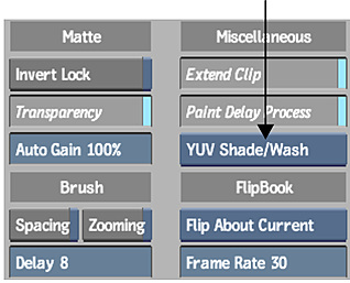

You can apply the colour using either the YUV or HLS.
To select a colour model:
To use Wash or Shade:
