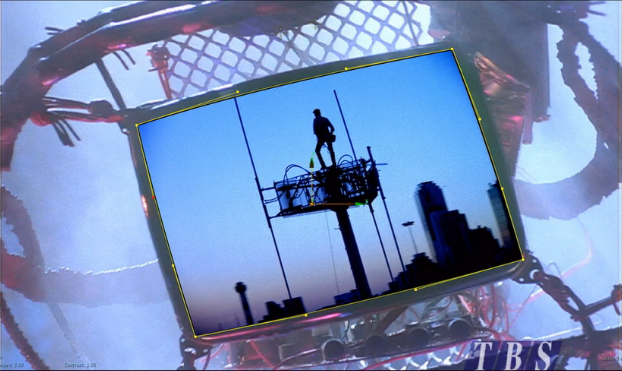

In this example, after tracking our bilinear surface, we change the surface type to Extended Bicubic. We then adjust the tangents of the extended bicubic surface, at frame 63, curving the surface for it to fill the TV screen.

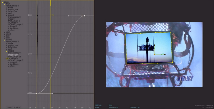

Looking at the user shape channel, in the Animation Editor, we see that only one keyframe is added, at frame 63. The adjustment or deformation persists after the last keyframe of the user shape channel and does not interfere with the existing tracking animation.
