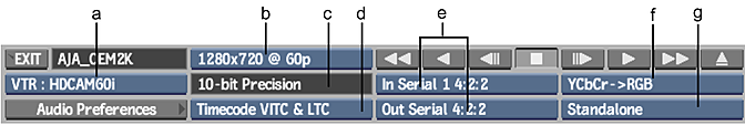

Device name box
The Device Name box differentiates between 3G and non-3G capable VTR and provides an option for each enabled VTR. To modify settings for a specific VTR device, select the corresponding option from this box.
Video I/O Timing box
Provides video timing options (resolution and frame rate) corresponding to different video formats supported by the video input/output board of the system.
Precision box
Determines the video interface precision, or SDI bit depth used. This value cannot be changed.
Audio Preferences button
Click to view the Audio Preferences menu.
Timecode Source box
Determines which type of timecode is obtained from the VTR device. Timecode VITC & LTC is the default, and recommended option. You should only have to switch to Timecode VITC or Timecode LTC if one of the timecode tracks is corrupted.
Select: To obtain:
Timecode VITC Vertical interval timecode (VITC).
Timecode LTC Longitudinal timecode (LTC).
Timecode VITC & LTC Both types of timecode. At normal playback speed, Smoke obtains LTC, but switched to VITC when the tape is rewinding, fast-forwarding, or otherwise moving at a non-playback speed.
Input and Output Connection boxes
These boxes determine the connection by which the video signal is transferred. This box is automatically set to reflect the selected VTR.
  • In Serial 1 3G / Out serial 1 3G: The video signal is transferred through one SDI 3G link. This is the only available option when you use a 3G VTR. The VTR Status field indicates any conversion that might happen because of the sampling used, 4:2:2 (conversion YCbCr <-> RGB) or 4:4:4 (no conversion RGB <-> RGB).
  • In serial Dual 444 / Out serial Dual 444: The video signal is transferred through dual SDI links; one video field is sent through one SDI cable, the other field through the other cable.
  • In Serial 1 4:2:2 / Out serial 422: Traditional VTR, single-SDI connection.
Colour Space box
Determines the YCrCb colour space conversion method. Headroom is only supported when you connect the VTR to an AJA device.
Select: To perform clip I/O with:
YCrCb->RGB A standard YCrCb-RGB conversion process that clips superblack and superwhite luma (Y). Use this option for typical clip I/O processes with VTR devices.
YCrCb->RGB + Headroom A YCrCb-RGB conversion process that preserves superblack and superwhite colour information. Use this option when inputting or outputting greyscale mattes or other clips where preserving extremes in the luma channel is required.
No Conversion This is available when using dual link for RGB input and output. Video black and white levels on the SDI stream are mapped to black and white values in RGB on the framestore.
Use this option in conjunction with 4:2:2 input and output connections to input and output 4:4:4 video using dual-links (4:2:2 and 0:2:2).
No Conversion + Headroom Also available when using dual link for RGB input and output. This mode uses all levels available and preserves all but a few RGB values.
Use this option with the 4:4:4 input and output connections to input clips from and output clips to a Telecine.
Output Sync box
Determines the output sync reference source. The reference signal may originate from several different sources. Select the source you are using from this box according to the following table.
Source type Available on: Description:
House All systems A centralized analogue reference signal, originating from a sync generator, sent to the genlock port on the video board or VBOB.
Digital 1 and Digital 2 Most HP® 8400s and all HP 8600s and 9400s Same as Digital, except you can choose between two inputs: Digital 1 or Digital 2. On the HP 8400 with the AJA SD (OEM-LH) video board, only Digital 1 is available.
Standalone All systems The reference signal generated internally by the Smoke workstation.

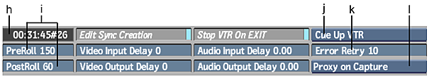

PreRoll field
Indicates the pre-roll, in frames.
PostRoll field
Indicates the post-roll, in frames.
Video Input Delay field
Indicates the video delay on input, in frames. If this value is incorrect, the result clip when you click Frame Grab in the VTR Input module does not match the frame you see in the preview window.
Video Output Delay field
Indicates the video delay on output, in frames. If this value is incorrect, the clip you output does not get recorded to the proper place on the tape.
Audio Input Delay field
Audio Output Delay field
Stop VTR on EXIT button
When enabled, sends a stop command to the VTR when you exit the Input Clip, Output Clip, Auto-Capture, or Archiving menu. For example, if the VTR is playing a clip, or if it is cueing to an in point, the transport operation in-progress is interrupted.
Cue Up box
Determines the speed of the cueing process.
Select: To cue up the VTR:
Cue Up VTR Using the internal cueing algorithm of the VTR.
Cue Up Fast Forward Using Smoke. Use this option if Cue Up VTR is too slow for far cue points, such as on the betacam SP.
Error Retry field
Indicates the number of times Smoke retries failed input or output processes.

Proxy box
Determines proxy management when inputting clips.
Select: To generate:
Proxy in Post Proxies as a post-processing step
Proxy on Capture Proxies during capture
Generating proxy during capture is the quickest method. Depending on hardware configuration of your system, capture may be performed in real time with playback. Some extra required processing, however, may prevent the graphics board from updating the image window and broadcast monitor in real time, so you may not be able to view the clip being played as it is captured.
