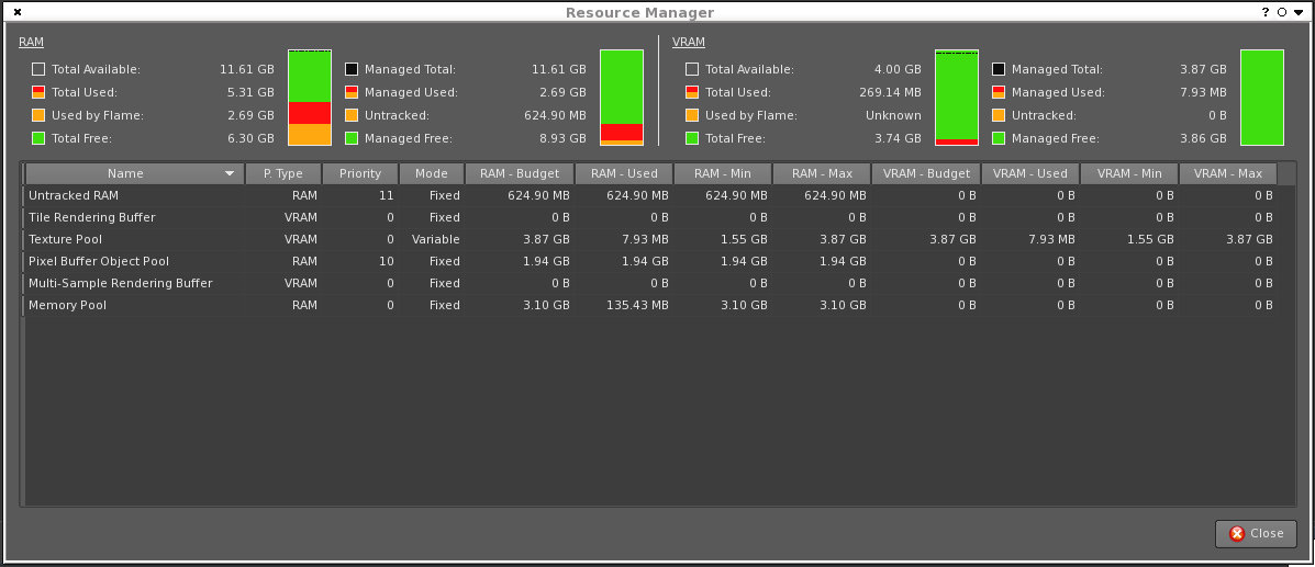

Resource Management
A Resource Manager utility is available from the Smoke menu. The Resource manager indicates the amount of RAM and VRAM that are Available, Used by the system, Used by the software, and Free. It also lists the RAM and VRAM clients, and details their memory consumption.
