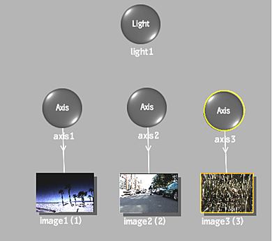

  1. Add multiple surfaces to the scene.
  2. Add a light to the scene.
    All surfaces are illuminated.

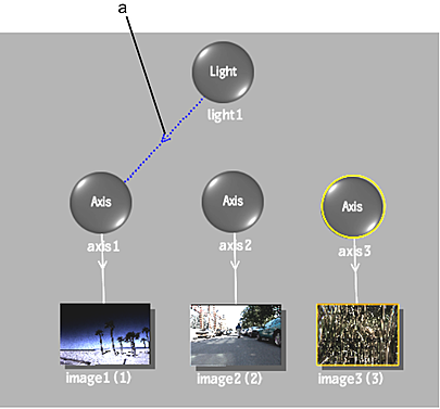

  4. To illuminate only a selected surface, click the light node, and drag it to an axis or image you want illuminated.
    The selected object is connected to the light source by a blue dotted line with an arrow, and only the selected surfaces are illuminated.
    (a) Light inclusion link  

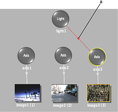

  5. To exclude a surface, hold the Alt key while clicking and dragging from the light source to the surface you do not want illuminated.
    Excluded surfaces are connected to the light source by a red dotted line with an “X”, and they are not illuminated. In the following example, all surfaces are illuminated, except for image3, which is excluded.
    (a) Light exclusion link  
