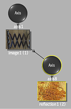

    The reflection object is added to the schematic with its own parent axis. The new axis is the child of the selected surface or geometry. In Schematic view, the number in brackets next to the name of the Reflection node indicates the media used for the diffuse.
    To specify different media as the reflection source, select the media in the Media menu, then click Apply.
