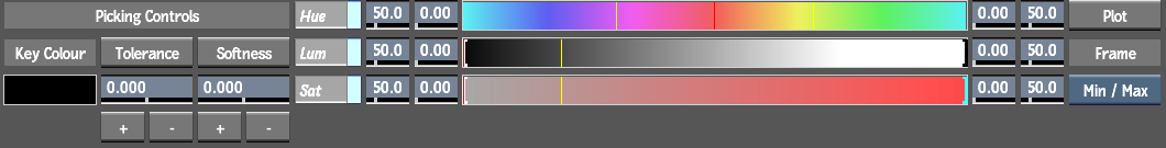

  5. Drag the colour picker around the area you want to key out.
    The average colour sampled by the colour picker appears in the Average Colour pot. In each channel of the colour model, the channel value of the average colour appears as a white line. All pixels in the key-in clip with the selected colour value are keyed out.
    The yellow lines in the colour model channels indicate the limits of the softness range. The pixels in the front clip with colour values at the centre of the range are black (transparent) in the matte. As you move away from the centre, the pixels become more opaque.
