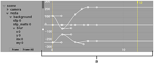

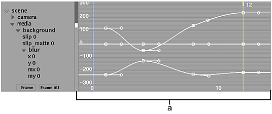

- Click the keyframe that will act as the centre of the X Scale. Drag left to decrease the value or drag right to increase the value of the other keyframes along the X-axis, relative to the selected keyframe.
(a) Original animation curve
(a) XScale used to compress curves

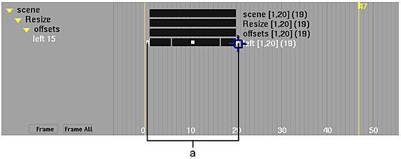

To scale a channel in the Track Editor:
- From the Channel View box, select Tracks.
- From the Tools box, select Select.
- Select the channels you want to scale.
- Drag the last handle to the left to decrease the duration, or to the right to increase the duration.
Note: To avoid adding keyframes between frames when scaling, press Option-Z while scaling. If you have already scaled the track, Select Frame Snap from the Curve Functions box to snap keyframes in the selected channel to the closest frame numbers.
The track scales as you drag the handle. All keyframes are repositioned proportionally in time.

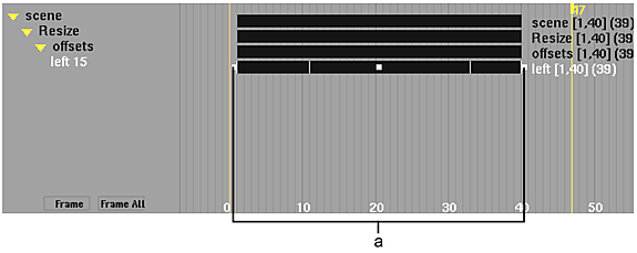

(a) Original animation track
(a) Dragging handle used to compress a track from 40 to 20 frames
