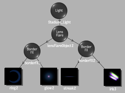

In the Action schematic, the components are attached to a Border FX object that is itself attached to the Lens Flare object. You can use multiple Border FX objects to achieve the lens flare look you want. For example, attach a ring and glow to one Border FX object, while a streak and iris are attached to another Border FX object. In this case, you can control how the lens flare behaves when it reaches the borders of your image differently for the components under each Border FX object.
Tip: You can also attach multiple Border FX objects to the same texture component, to compare different Border FX settings, for example. In this case, you can use the Action Hide button to hide each selected Border FX node to see the different results.
