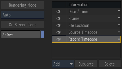

General Settings
Rendering Mode box
Select Automatic to render using the scan format of the input, or render in Progressive or Interlaced mode.
On Screen Icons button
Enable to display layer positioners in the viewport. Use the icons to move the layer in X and Y, or rotate in Z. Alignment options allow you to affect only the selected layer or every layers.
Displayed Information list
Lists all of the added information layers. Use the buttons below to populate the list with the information layers you want. Use the eye icon to mute a layer. Click a layer to display its Layer Specific options.

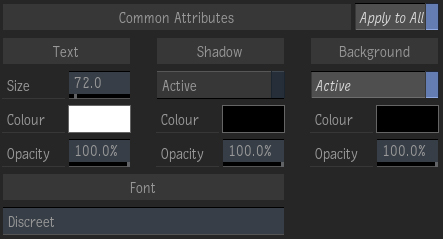

Common Attributes
Apply to All button
Enable to have the Common Attributes applied to every layer already in the Displayed Information list. Disable to apply the attributes only to the currently selected layer.
Text Size field
Displays the font size of the burned-in text. Editable.
Text colour pot
Select the current colour of the burned-in text. Select to open the colour picker.
Text Opacity field
Displays the opacity of the burned-in text. Editable.
Enable Shadow button
Enable to add a drop shadow to the burned-in text.
Shadow colour pot
Displays the current shadow colour. Select to open the colour picker.
Shadow Opacity field
Displays the opacity of the drop shadow. Editable.
Enable Background button
Enable to add a rectangular background to the burned-in text.
Background colour pot
Displays the current background colour. Select to open the colour picker.
Background Opacity field
Displays the opacity of the background. Editable.
Font field
Displays the font used for the burned-in text. Editable.
