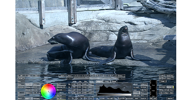

In a number of tool and effect menus (such as the Colour Corrector and 2D Transform), you can use the Overlay user interface. Its controls are identical to those on the regular user interface except that they are transparent and appear on top of the image. This allows you a greater viewing area when working with large or zoomed-in images.
To display the Overlay user interface, select Overlay UI from the Viewport Layout box.

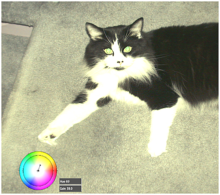

In addition to the increased area provided by the transparent controls, you can view even more of your image depending on the action you are performing. For example:
