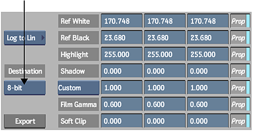

The Conversion LUT Type and the field values are all updated with preset conversion parameters. In ConnectFX, a note is added with a description of the preset's usage.

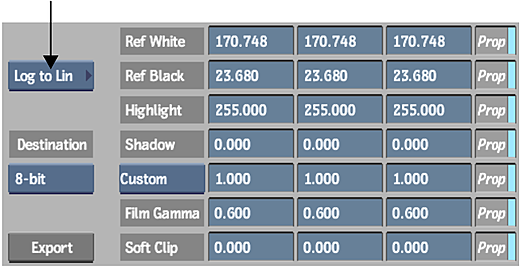

Select: | To: |
Colour Transform | Apply a colour transform based on the Academy/ASC colour transform XML format, as well as several other supported LUT and transform formats. |
PhotoMap | Begin with a default curve for tone mapping. |
3D LUT | Import a 3D LUT. Note that 3D LUTs are not available for floating-point values. |
1D LUT | Import a 1D LUT. Note that some 1D LUTs are intended for integer values and others are intended for floating-point values. |
EXR Display | Begin with a default curve for tone mapping. |
Gamma | Begin with a default curve for modifying linear data. |
Lin to Log | Begin with a default curve for converting linear or video data to logarithmic data. |
Log to Lin | Begin with a default curve for converting logarithmic data to linear or video data. |
The file browser appears.
When importing a colour transform, see Autodesk Color Transform Collection for a description of the available categories.
You are returned to the LUT Editor. The LUT name appears in the field next to the Import button.
